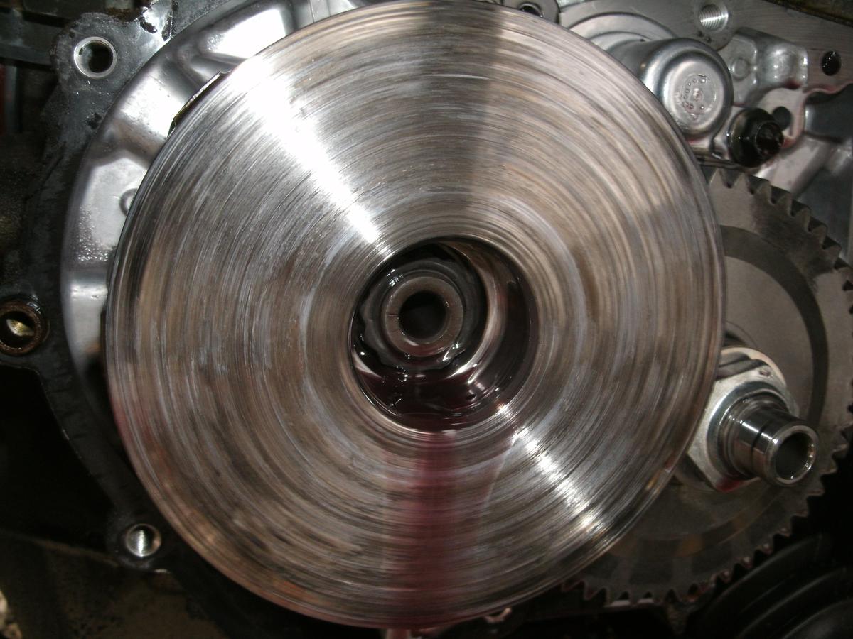

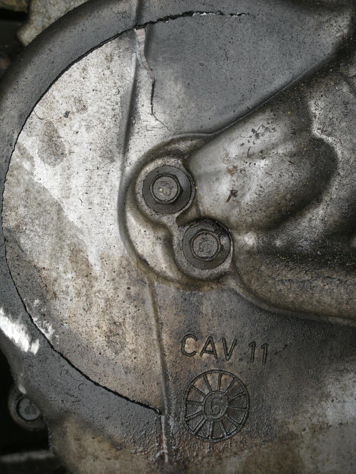

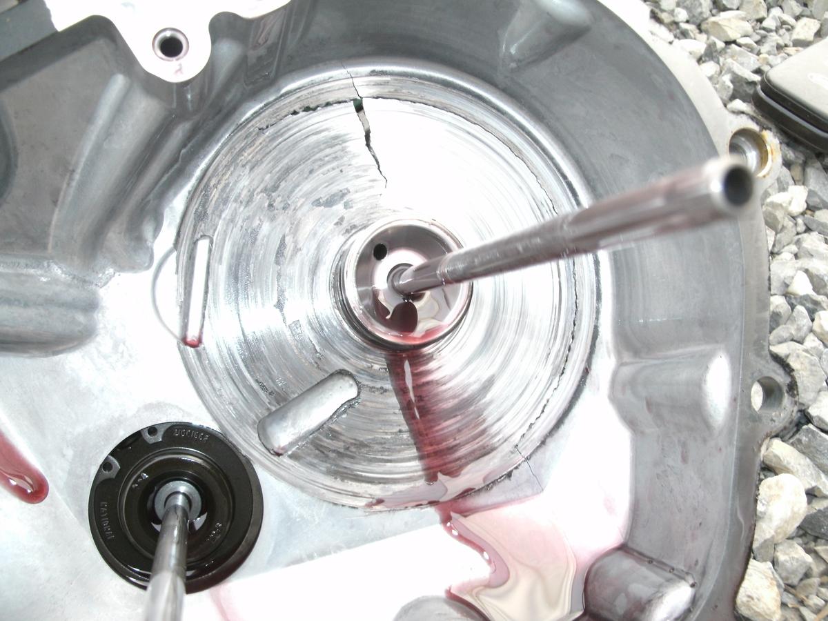

Wow! How did this thing even work?
Finally had a chance to check the transmission thanks to an additional vehicle and a great deal on a portable garage. This is what I found.
Yeah, a few thousand miles with the input shaft nut loose is not a good idea.
I'll put more pictures up in a bit.
Now I need to get another case cover and probably another clutch pack since this one's been severely overheated and almost worn through on the back side.
At least now I know why it was leaking so badly.
