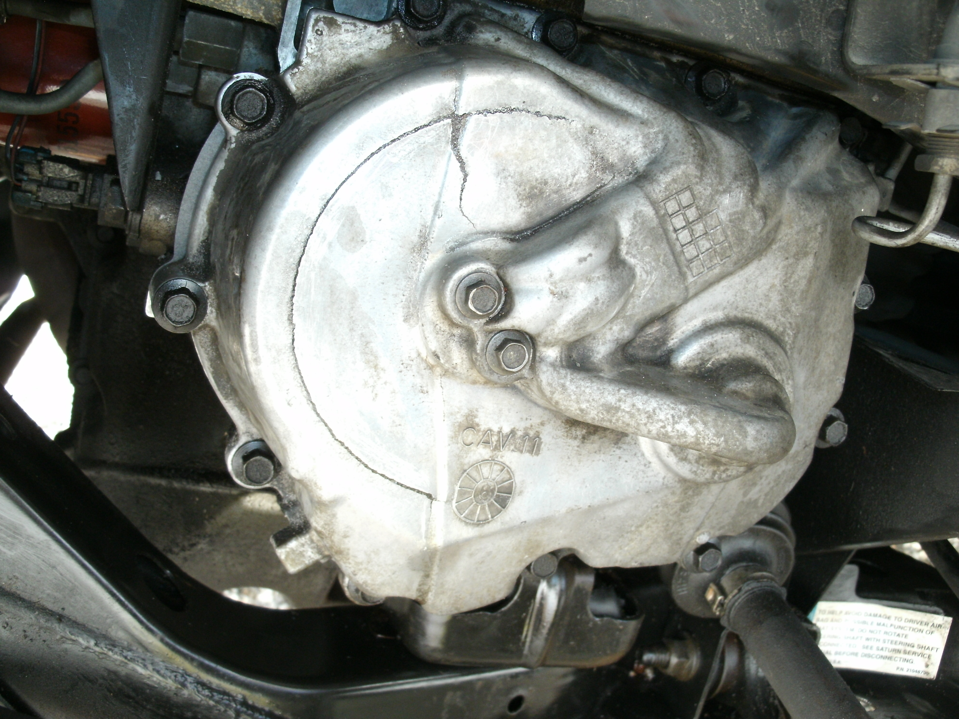

Today I went ahead and tried the Q-Bond approach. I cleaned up the case cover and took the burrs off that the rubbing clutch pack had created. I did notice that the cylindrical part that one of the tubes goes into, the one with the two o-rings, had some wear on one side where the case was flexing and allowing the input gear to move off center. I'm not sure how long this will last but after I used the Q-Bond and put it all back together I don't have any leaks and reverse and second gear are back. So it's kind of a reserved yay! I figure I'm going to have to baby this thing to keep the stresses on the case cover to a minimum. Some additional good news (and it's only now that I can be absolutely sure) is that the used valve body I put on there is indeed a good one. No reverse slam at all.
I must note that I did not use any sealant on the new case gasket. I did not change the fluid or the filter, only brought the level back up to normal. I would have liked to do more but this is what I can do for now. That truck has put me so far behind financially with all the gas that thing uses that I'm in survival mode now.

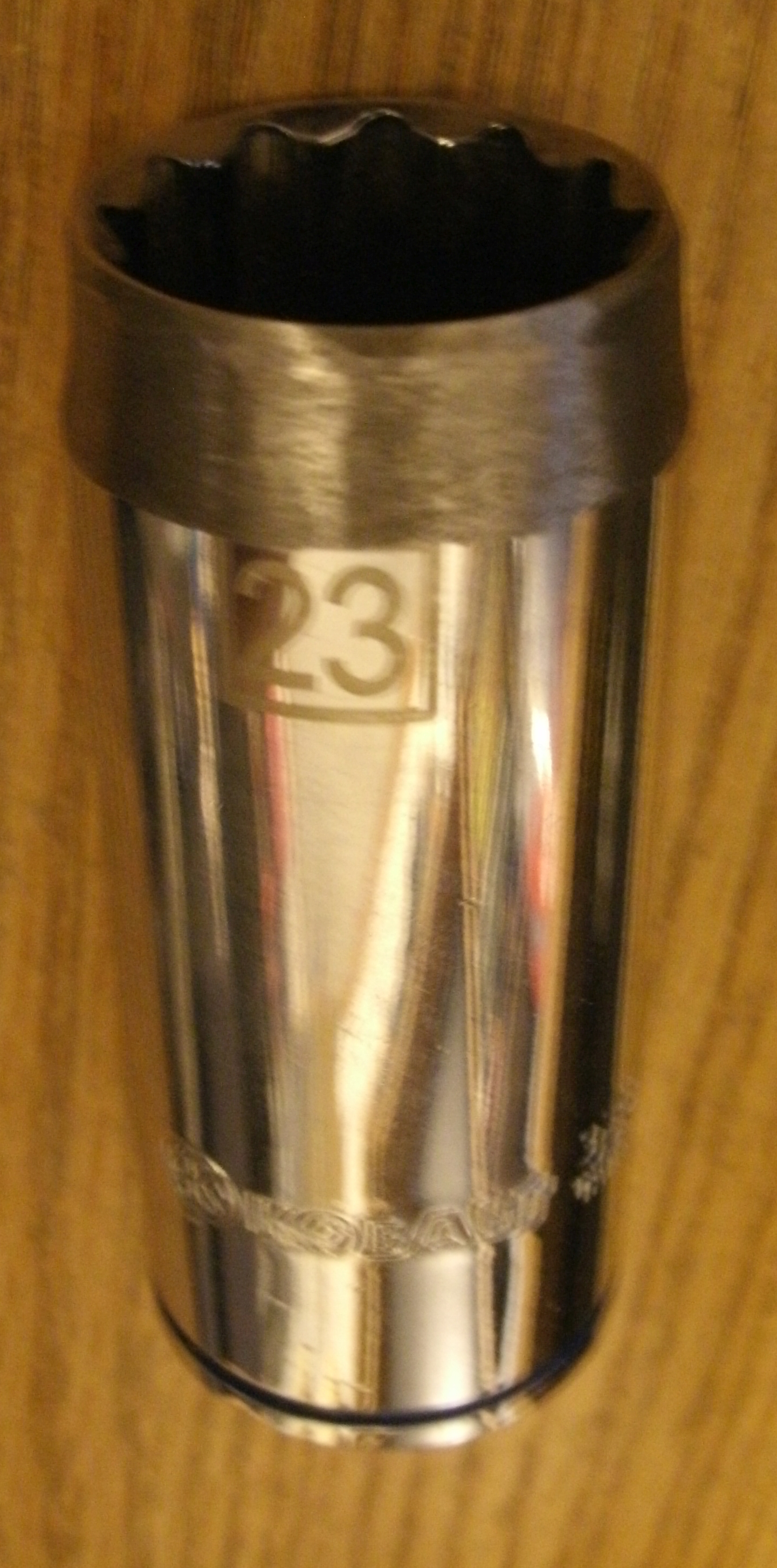

Here's some pictures of the "fixed" cover. Not much to see but at least I can't see the clutch pack through the cover anymore. Also a pic of the 23mm 12 point deep socket I modified for tightening the nut.

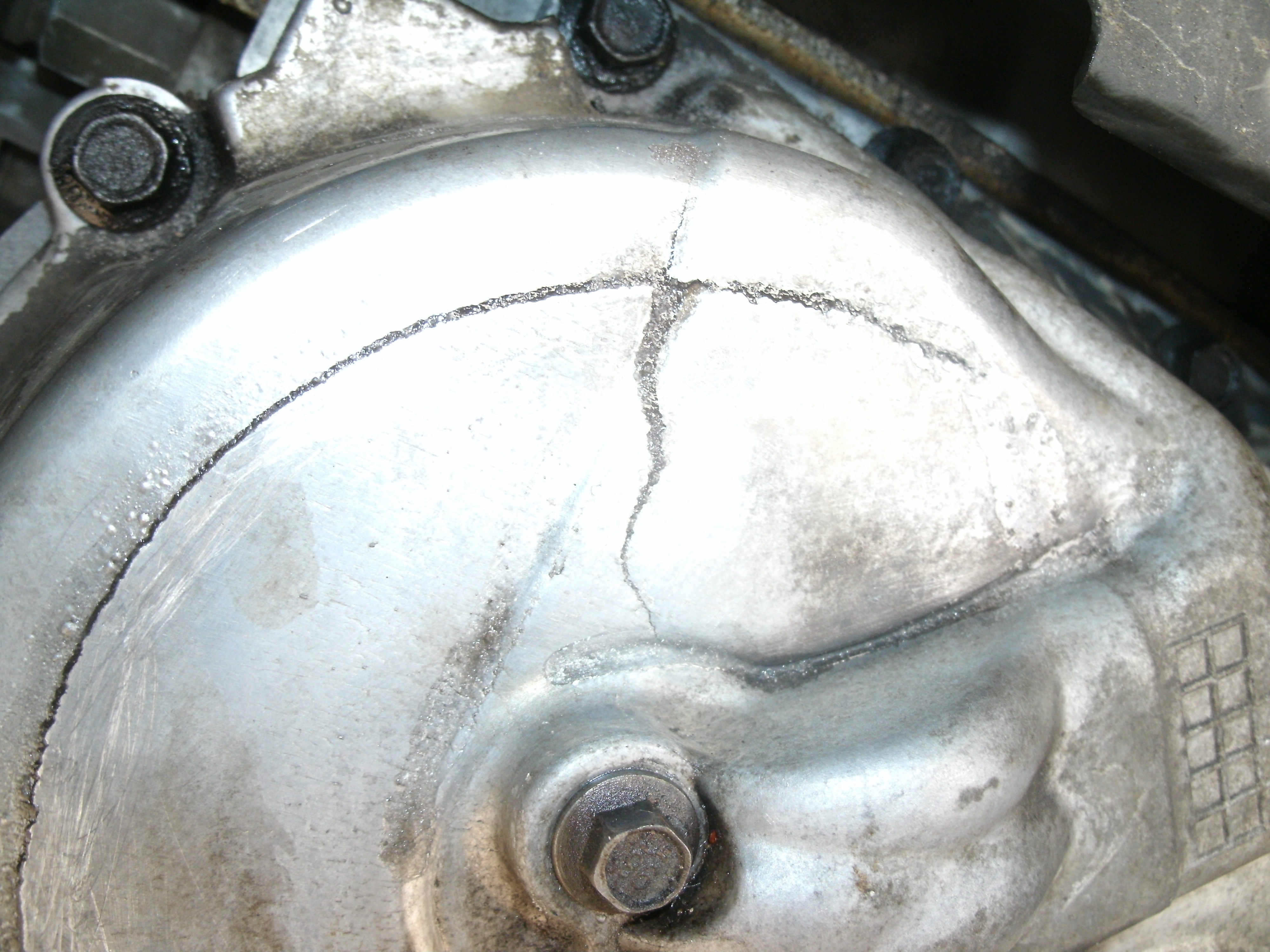

@Derf, the crack was indeed all the way through.

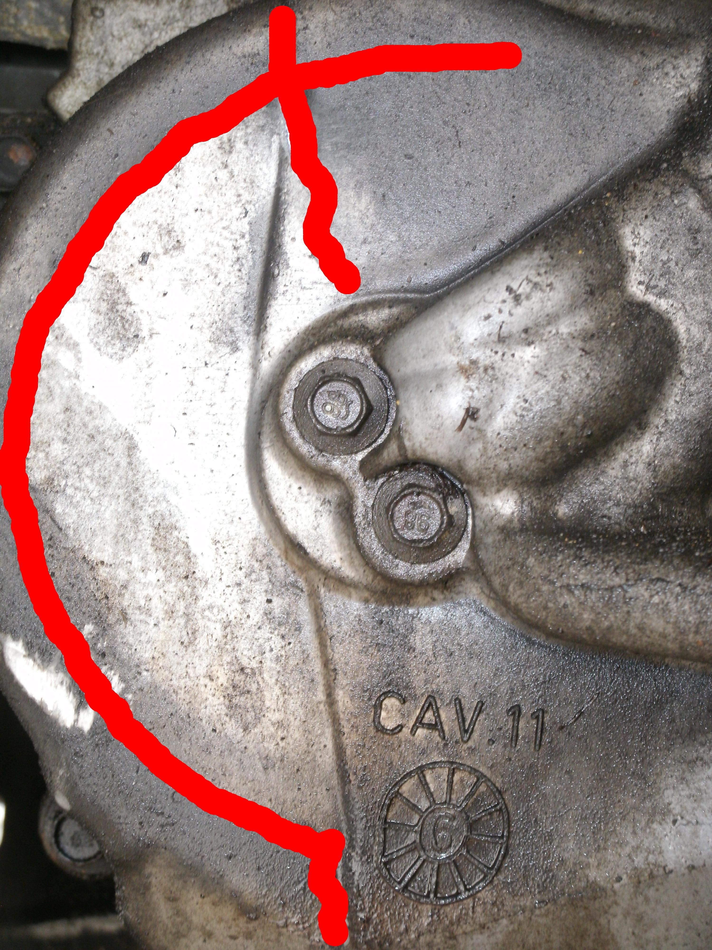

If you look at the first tranny picture above, you can actually see the clutch shell through the case cover near the top of the crack. That's about a 3/16th inch opening at the widest part. The rest of the circular run of the crack was fully separated and warped outward a few thousandths. There are two vertical hairline cracks going outward at the ends of the arc that, while not gaped open do indeed go all the way through the thickness of the case. I've added a picture with the crack highlighted in red where is goes all the way through. If I had not seen this stuff work with my own eyes I would have (in fact I still do) had trouble believing the Q-Bond would work.
Q-Bond is a two part product with a filler and cyanoacrylate(superglue) based binder. The powder is like fine sand and after cleaning the case around the crack with coleman fuel, contact cleaner and acetone (in that order) I rubbed it into the crack, packing it in the best I could. I had to back the crack with tape to hold the powder in the crack. Then I simply dribbled the liquid superglue onto it and watched it wick into the powder and all the way through the crack. It actually built up a layer on the inside of the case too. Not too much but the glue is now holding from both sides. It cured in less than a minute and I was pulling off the tape and starting reassembly.
